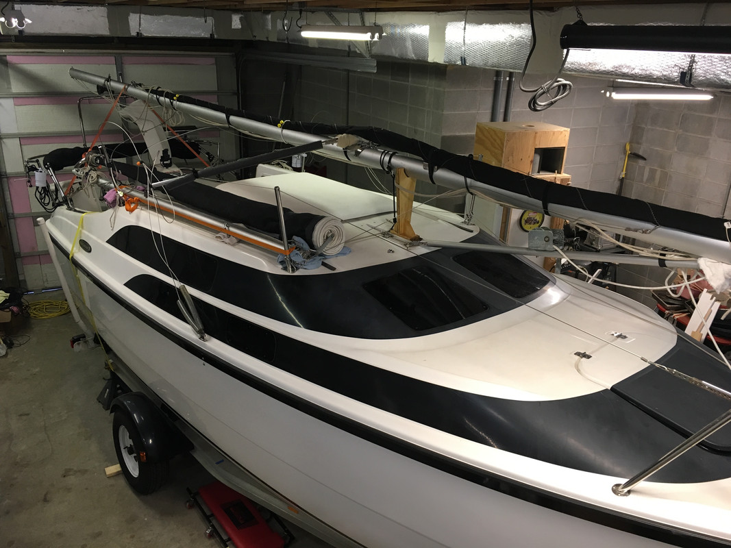

I leave my MRS on a lot as well. Towing configuration shown below (captains seat down on road). One thing I don't like about the M MRS is, it has a lot of sharp corners to scratch the deck. I typically throw some towels under it, but it would be nice to put some rubber feet under it to keep bolt ends and the winch handle off the deck.

HEY! You have a furling main! You never told us you have a furling main. What's that wooden box for with the hole in the top of it? Do you have a welder in the corner? You know how to weld! ? (I want to know how to weld
I thought fluorescent light fixtures were illegal. (What's that yellow and black stick thing with the curly cue on the end?)
Is that your garage?
(i like your creeper)
i don't think that little wood block is big enough to keep your boat from rolling away in an earthquake
- Jimmyt
- Posts: 3402
Re: Mast Raising Alterations 26M
Yep. I may have mentioned the furling main before.BOAT wrote: ↑Thu Feb 27, 2020 4:15 pm HEY! You have a furling main! You never told us you have a furling main. What's that wooden box for with the hole in the top of it? Do you have a welder in the corner? You know how to weld! ? (I want to know how to weld)
I thought fluorescent light fixtures were illegal. (What's that yellow and black stick thing with the curly cue on the end?)![]()
Wooden box with the hole is the fan section of my homemade dust collection system.
I have a small TIG/stick welder. Don’t know if it’s in that pic. You may be seeing the top of my air compressor. Whether I know how to use the welder or not is a separate matter and up for debate. You can do it. If I can learn, anyone can.
Legacy fluorescents. Since the garage didn’t get fire damage, no lighting replacement. Nothing is illegal in Alabama.
Gutter cleaner - don’t waste your money. I got it for free and consider it a ripoff at that price.
That is my garage/basement. When you buy the cheapest lot in the neighborhood, that even the crazy builders didnt want, there are opportunities to experiment. Dug a hole into the side of a hill and planted a house in it. Basements aren’t real popular, but they are done.
Thanks - it’s just creepy enough to suit me.
Very few earthquakes here. Hope it doesn’t roll over that block.
If I didn’t know better, I’d think you were pulling my leg just a tad!!!
