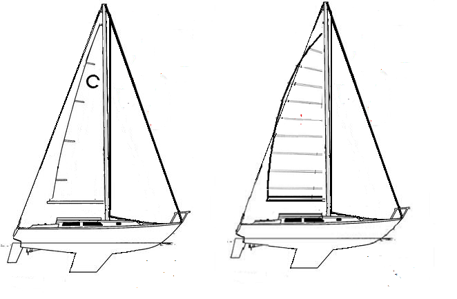

They go under a variety of names, but if I have one for my
, they should be out there for an
I have found that that sail is great for lower wind velocities. Those are the conditions I used to sail in often. I also believe that I had to reef earlier than I had with the original main. I have seen a post on this site from someone who says they also own a flathead, and they have seen no need to reef earlier. Either way, there is more sail area higher up than with a conventional sail.

Maybe you mean 'flathead'? Or 'musclehead'? Thedlandersson wrote:Seen some stuff re: flat sails for the M - apparently provides more square feet for wind when sailing. Anyone heard of anything like that for the X?
At least, that's what I'm guessing you're referring to. If it's a sail with a flatter cut, then I don't know.
