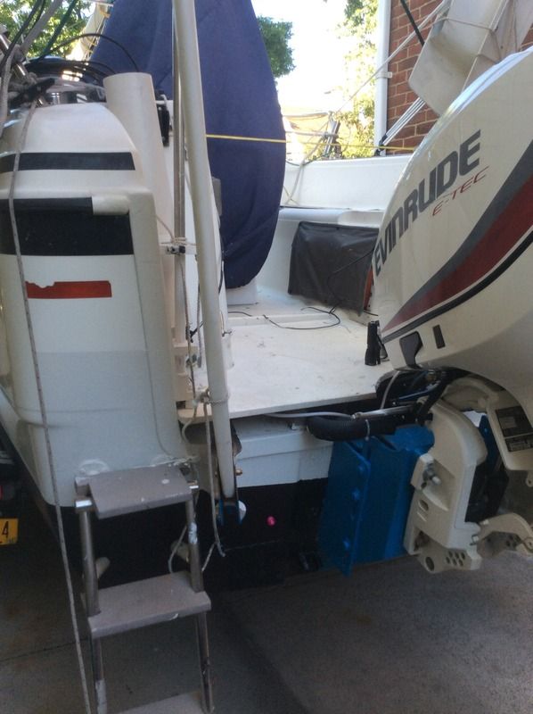

A Picture is worth a thousand words:
The Blue is a 10" Jackplate. Bass boats mainly use them to get their props up higher in skinny water. I found it helped raise my motor ~ 5"s which helps it stay completely out the water when lifted up. Also sets right cavitation to hull bottom height. It is painted with an epoxy barrier coat, Tuff Stuff fr SeaHawk & then a bottom paint suitable for Aluminum or metal, so there's no more EXTRA galvanic corrosion :x
eg:-That's white Tuff Stuff in pic above ladder. I used it to seal transom when I raised bottom paint line. Note pink cap showing motor well drain.
Notice the amount of extra real estate I got putting my motor back on a jack plate. While I sawed off the horizontal of my captain's seat for extra cockpit room. It also removes any thought of hitting the hinged seat. I covered over my SS steering bars, so I gained almost 30"s with the motor moved back. It's also very easy entry/exit off stern ladder, in or out of water :wink:
PS: I also switched my Captain seat hinge from Port to Starboard to free up area by my rear boarding ladder
