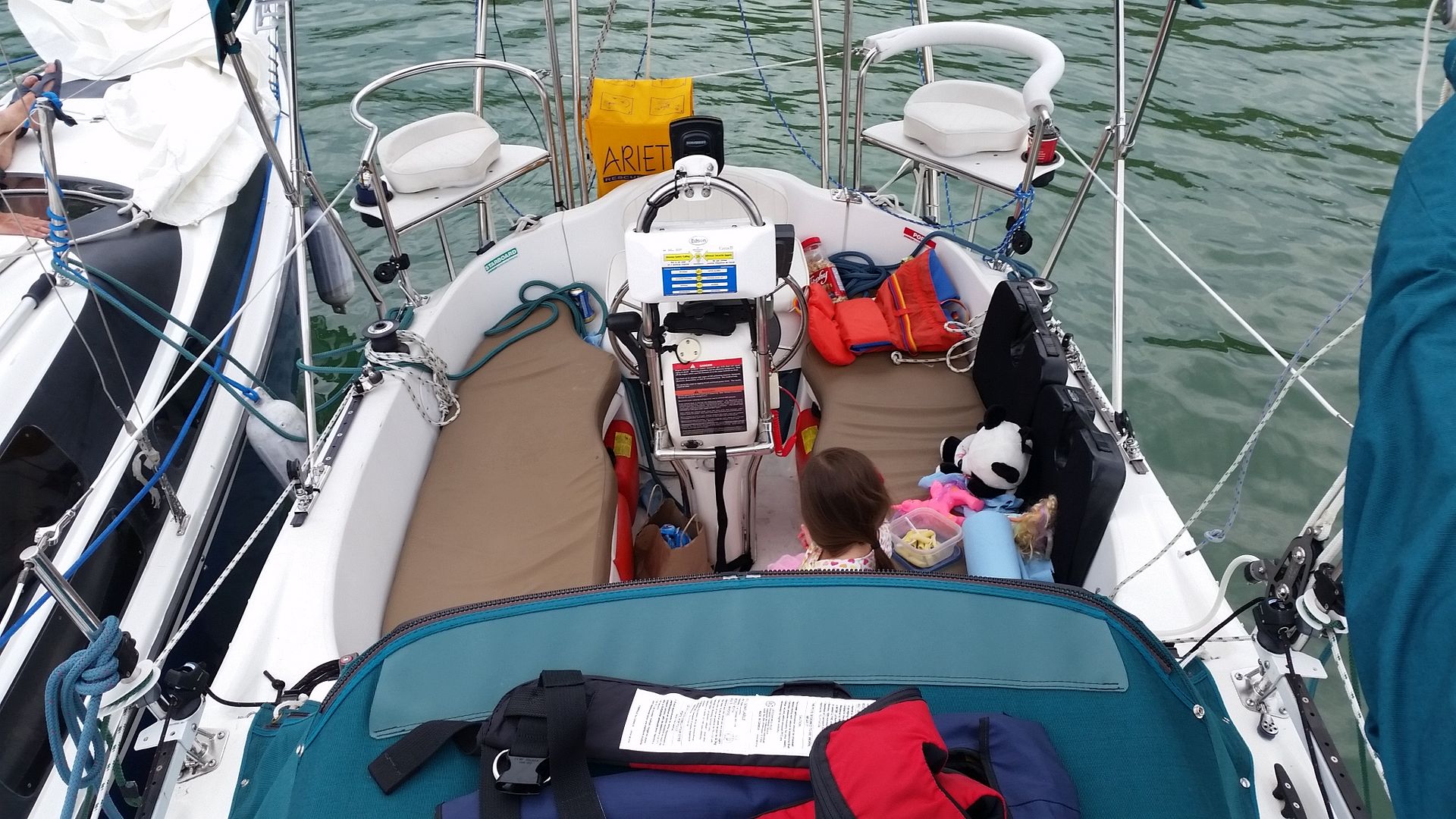

Ur answer is yes I used plastic cutting board underneath my lewmar # 7 winches on the aft cockpit as backing plates heated the plastic backing plates before installing them so they would bend to the slight curve on the gunwale
hope this helps u all out
u can see them here in the cockpit also

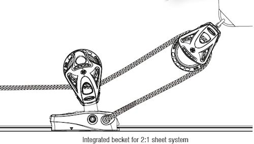

An alternative to winches would be to rig the jib/genoa sheets with a 2:1 purchase. A lot of sport boats do that.
