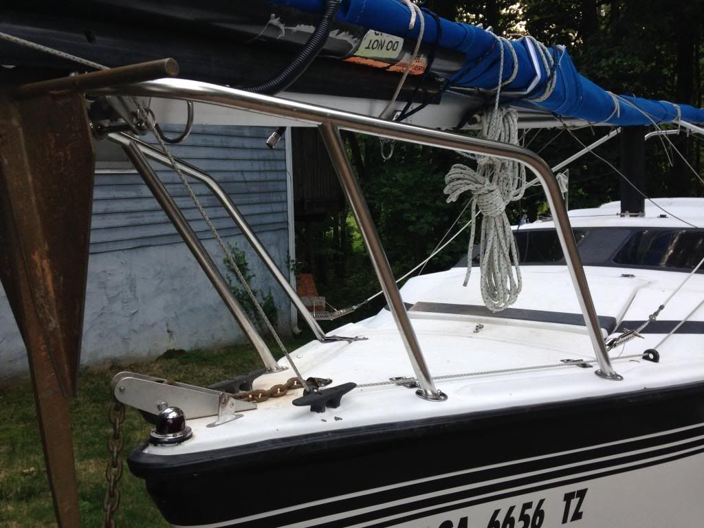

Here is how mine is set up until I get a different anchor and roller. I slide the pin in the anchor roller through a link and that holds it from coming out.
