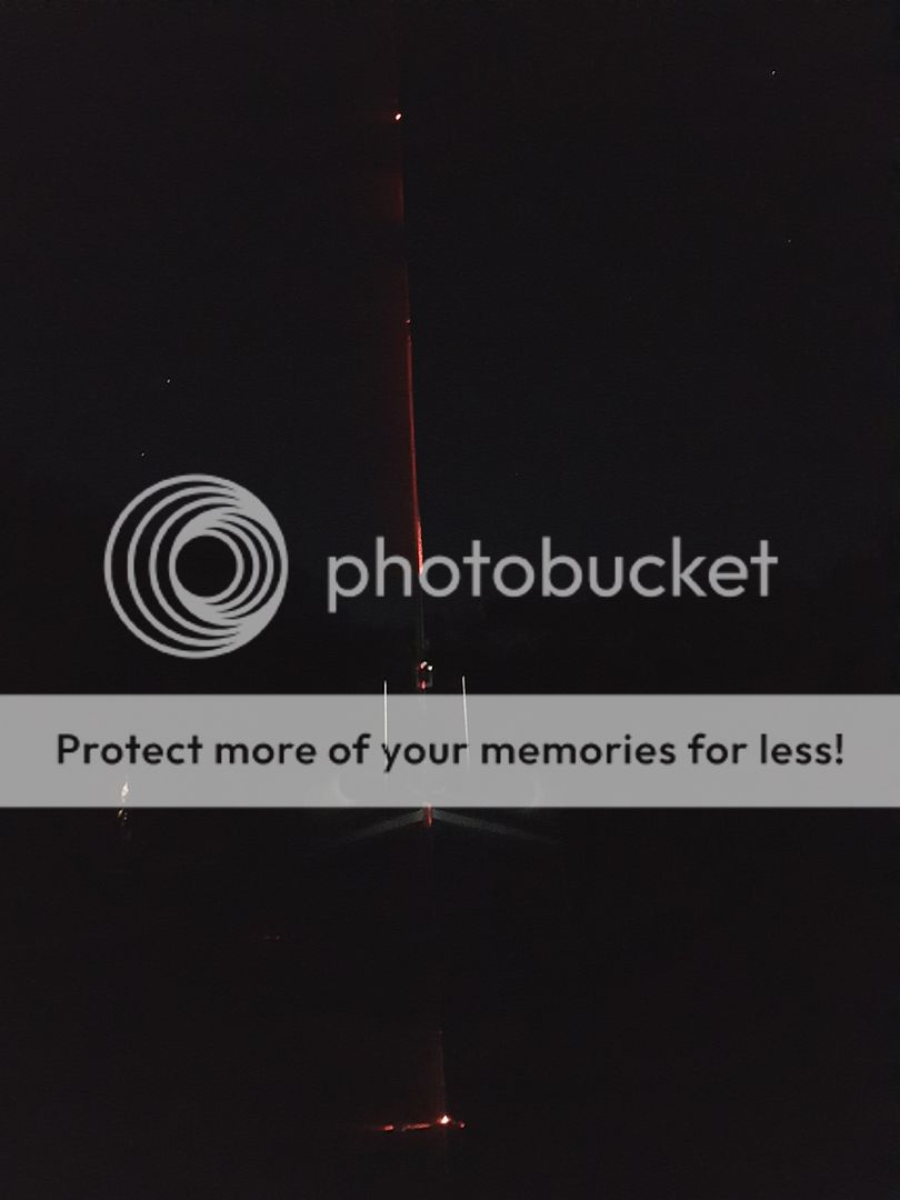

Got the self leveling laser out tonight. Set it up on the ground in front of the bow and confirmed the horizontal level (which I'd previously set with a long spirit level across the hatch opening).
Then switched on the vertical laser and it traveled from the base to the tip of the mast...Dead vertical, no problem

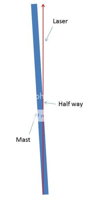

Then I set up the laser on the starboard side, on the ground. Confirmed horizontal and the vertical laser drew off of the mast about half way up....
Considering its a 4.5" Mast I guess that means the top is leaning aft about 9"?... hope that makes sense?
