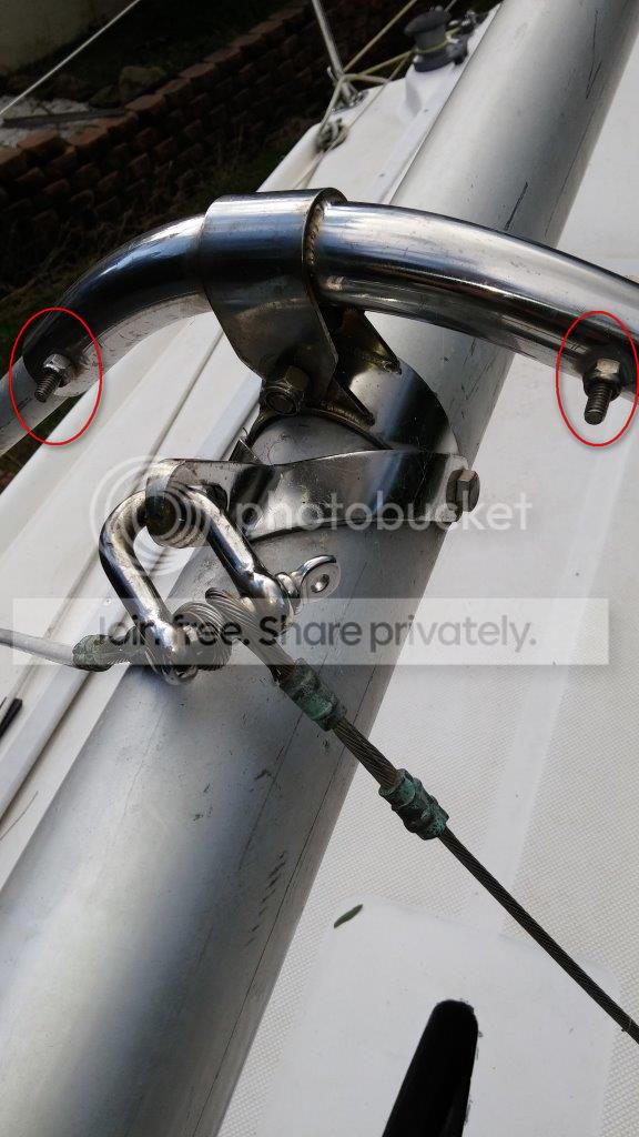

My (broken) Mast is with the Mast builders and I need to calculate some tube lengths for the telescopic tubes. Could someone kindly measure the distance between the spreader attachment bolt and the safety wire on their 26M?
Also how much does the spreader tube protrude past the point of the safety wire (not including the spreader tip) ... This would help me confirm my calculation.

Please clarify what you mean by safety wire. Boat is downstairs, so I'll gladly measure for you - just need to understand what you want.
43 - 3/16" from bolt center (circled in your pic) to outer tube end (1097mm). If that's not what you want let me know.

Jimmyt wrote:Ok - my mast is typically flat with spreader disconnected. I'll try to work out a projection measurement as you show it - mast face up with spreader attached. Give me a minute.
Hi Jimmy, Please don't go to any special effort for the moment.....Because I might scrap the whole telescopic idea. :|

I think Tom's approach would be better than a two piece spreader, but if you want to try the two-piece approach, I'm measuring about 30 inches for the first section to just scrape the lifelines. This is from your circled bolt measured along the spreader pole. Shorter is better. If I was trying it myself, I would go with 22-24 inches, due to everything flopping around during moving the mast in and out of towing position. Also, I had to project the lines, and nothing is square or plumb.
