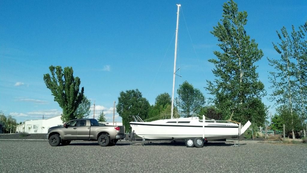

Thanks but I'm no going to sell anytime soon. This boat is quickly becoming an obsession. Any advise on the fiber-glassing?
Posts: 5007
Re: Should I fix this?
Nice tow beast. :)
philip8614 wrote:Thanks but I'm no going to sell anytime soon. This boat is quickly becoming an obsession. Any advise on the fiber-glassing?
