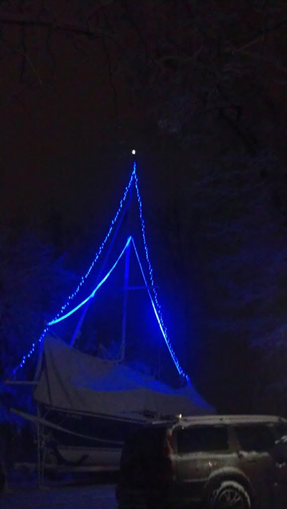

Ok, the boat taking a drive on its own is pretty impressive. I am not sure how the following would help in a hurricane but,
I use a car disc brake rotor under my trailer jack wheel - it keeps the wheel from sinking into the asphalt and it prevents the trailer from rolling.
As far as a cover, I store mast up, add a pole at the bow and another at the stern, run a ridgeline, and lace up two 7 x 30 foot tarps, one on either side. Oh, and I string up x-mas lights :) Image
