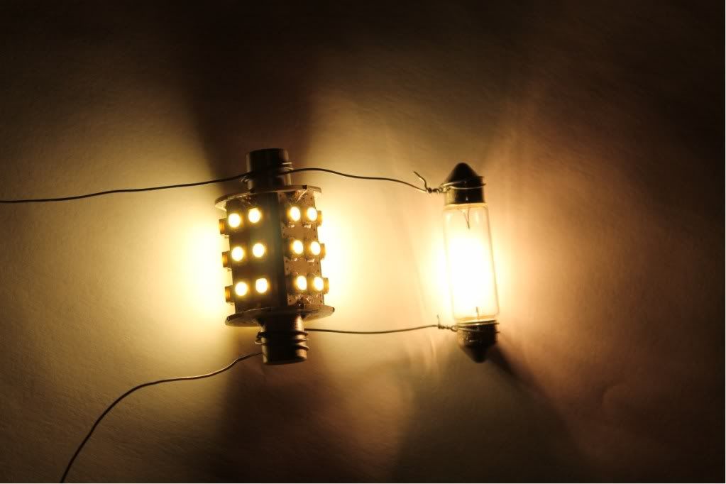

I used these in my nav and steaming lights.
http://www.amazon.com/LEDwholesalers-Na ... toon+bulbs
You need the warm white in the bi color bow light.
LED next to the original bulb.
LEDs photograph differently. Here you can see the light shadow of the LED is much bigger.

Thanks Russ, as usual, a awesome answer. Does it matter the original bulb has pointed ends? I have never even looked under my lens.

Nope. End shape is not important. The lens pops off by pressing up on a tab on the bottom. Inside are two metal tabs that are spring loaded that pinch the bulb and make contact. The bulb is held in by this pressure. You can bend the metal tabs to add more pressure if necessary. It's a very simple design.
I don't remeber if the bulb requires proper polarity. If it doesn't light, flip it over.
