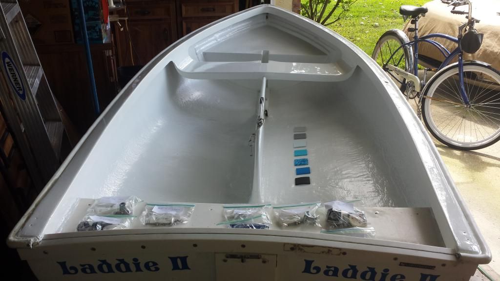

I have used rustoleum marine paint on my 10 ft O'Day Sprite dinghy.I used the topside paint to do the inside. I would say it gave reasonable service for about two years. Then, it began flaking and wearing off. I bought it then because it was inexpensive and handy. I picked it up at Lowe's. This summer I ground down and sanded the interior and did some fiberglass cloth and epoxy repair and strengthening. I, then, repainted the interior with with two coats of a two stage epoxy primer (Epoxy PrimeKote 404) from Interlux and added three coats of a polyurethane top coat from Pettit (Easypoxy). Wow! What a difference! I think the added expense and effort has really made a difference in the look of the interior. I will be very surprised, if it doesn't also wear much better, too. So, I would say the Rustoleum would be OK for a quick and dirty spruce up, but I will certainly go with the good stuff for major efforts in the future. :) Here are two pictures of my recent paint job with the Interlux/Pettit combo.
