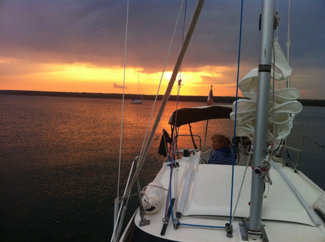

I solved it with a "Down-Haul" (my term). Not a continuous loop like Jim King's but it works quite well.
I added three clutches. First Picture shows them. Inside white line is the daggerboard. Middle flecked line is my mainsail down-haul. Blue line on the right side is my mainsail halyard.
Second picture shows the blue halyard and flecked down haul runs to a double cheek block to blocks at the base of the mast and up to the same point at the top of the sail where the main halyard connects. I just use a bowline to connect it.
I had to add the BWY mast gate. With this set up, I rarely have to go up to the mast for sail handling.
Doug
