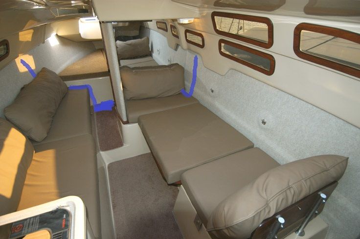

I have a 2007 Mac And have a MAJOR water leak I can not figure out. I am prepping the boat for this season and I have a major water leak. whenever it rains I get about a 32+ ounces puddled up around the head area. I spent 4 hours on Saturday with a hose on the windows the stanchions and deck fittings...after all that I got a slight trickle coming down the interior walls. It is not from the head plumbing because I had pink anti freeze in it and this liquid is clear. Has anyone had leaks like this? See Blue area in Pic

Considering the fact that the tape starts up the side of the hull in the carpet area I suspect you have a leak from the rub-rail. Check the outside for gaps check the entire rail. If you get lots of good sun on the rub rail, you will see light from under the clam shell from the inside where you have a problem. Or you could have someone use a flashlight at night.

Have you checked the chain plates? This is a common leak area and, indeed, your arrows on the photo nearly point directly to them.

+1 on chainplates...new to Macs, but they are a common source of leaks on sailboats.

Ihad the hose on the Port chainplate for 45 minutes and nothing noticeable...I am going to try the Starboard side next....Thanks for the input!

In this case of course the crack at the bottom of the DB would not be the OP's leak source (when raining). But cracks where the DB trunk meets the hull on the outside!!! Yipes. I thought that was a very robust area of the boat, and I'd worry about that when the boat's in the water (movement). Could that be from freezing, running hard aground or something? What year is yours, Bob?

) - When new,I had a leak above the head (not far from where drawn on the picture) where the dealer-installed pumpout fitting met the deck. I removed and sealed the fitting to the deck properly, and no leak since.
