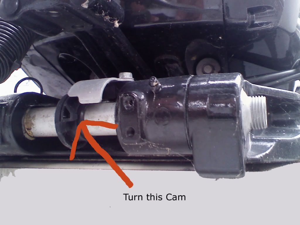

yukonbob wrote:Mine Suz 70 doesn't. It hits the captains seat. Barely comes out of the water but is a couple inches below max when it hits, cowlings got some good rub marks. This is well documented by BWY.
Weird. I bought my boat from BWY and it looks like they installed a plastic wedge behind the motor mounts.
When I first bought the boat, the top of the motor hit the helm seat. Did it so much it scratched up the cowling pretty bad. Then I learned there is an adjustment on the Suzuki base that limits the top end tilt. The motor will tilt totally out of the water, but just barely above. When the boat is fully loaded and people in the cockpit it will sink down and dip into the water.
yukonbob
Posts: 1918
Location: Whitehorse Yukon
Re: Best outboard and Size
Post by yukonbob »
That's good to know. Mines from BWY as well and has the same wedge. I'll have to look into the tilt limiter?? I usually just watch and wait til i feel it just nudge the seat then back it off. If it would just stop a little early the problem would be solved. I plan on getting some touch up paint this year and give the cowling a much needed paint job. When we're down at the boat the motors in the water, unless we're sailing and if its in the water a bit I'm not too concerned. I just want it completely out during the week when we're gone. Thanks Russ that's really awesome to hear about that feature :)
Posts: 8398
To be honest, I found this by breaking it. Another member here showed me.
http://www.macgregorsailors.com/forum/v ... lt#p165751
