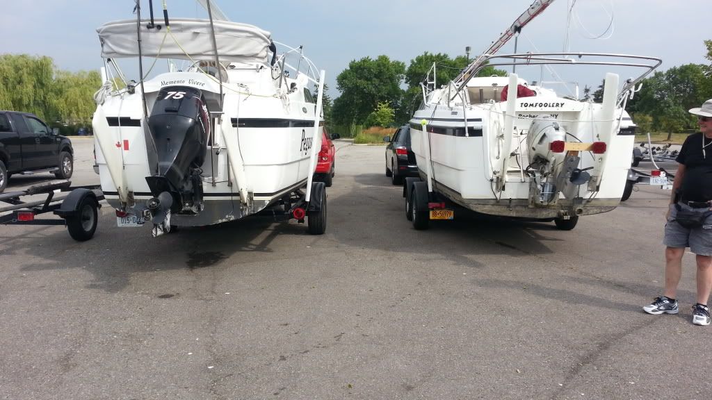

I think it is not necessarily the weight, as I am not sure they weigh any more than the stock ones
Stock are fiberglass
IDA are solid plastic from what I can tell
I think the difference is more in the thickness
The stock ones are longer, thinner and rounded at the bottom
IDA rudders are thicker, making for more lift, like an airplane wing adding slots/slats/flaps
They are shorter and straight across at the bottom

in this short vid right @ the beginning u can see the Ida Sailor Rudders on Beene"s u'll notice they r wider also , if u listen to the rest of the vid u'll here me giving Beene some well deserved constructive advise LOL
