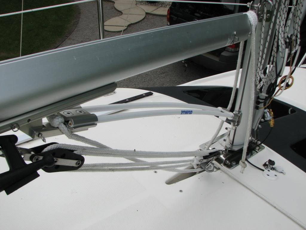

halyard jib & genny & spinnaker blocks should not be on a swivel some come with a lock to stop them from swiveling , main halyard block is bolted onto the mast side ways so cannot swivel !bscott wrote:Replace the dinghy size turning block at the mast head with a quality 2" swivel block and the main will fly up the mast. I also installed a chicken head to move my back stay and topping lift away from the sail roach.
Bob
http://i235.photobucket.com/albums/ee20 ... 010035.jpg
