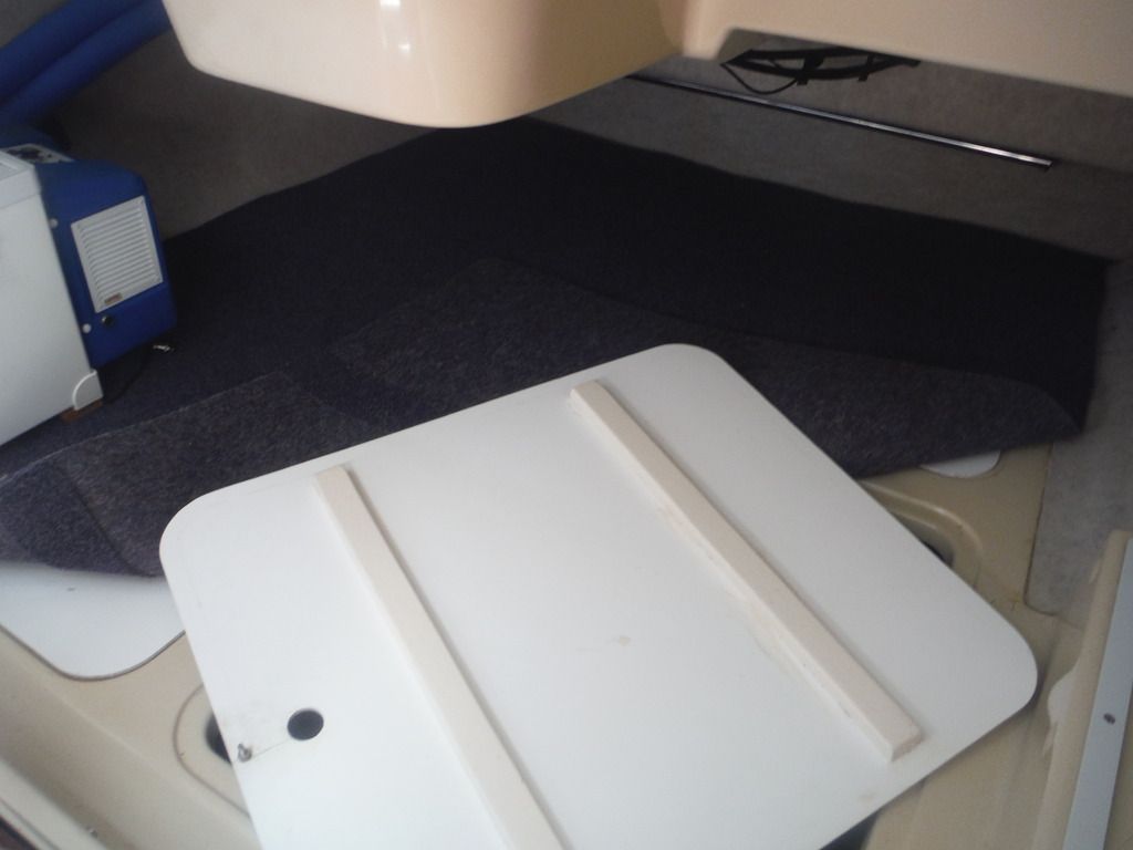

Another option, which was simple, quick and cheap.
I just glued and screwed some Pine battens across them which means they can no longer slide around, and don't collapse in as they can handle enough weight.

Mac26Mpaul wrote:Another option, which was simple, quick and cheap.
That's a simple and effective mod!

That is a good alternative.
And I suppose the cross pieces cut to the right length will actually make the covers fit in place properly. It doesn't seems like a one of them sits perfectly in the grooves.
Way better than the bolt and hole setup the factory uses....

The bolt and hole stops forward/aft movement and the battens are cut to just fit in so they stop sideways movement. I have a piece of outdoor carpet over the lot. It works fine and took about half an hour and then a lick of white paint to match the hatch covers. Was well worth it.
Of course you could add a forward/aft batten for even more support and then you wouldn't need the bolt and hole deal at all, but I find it works just fine like that.
