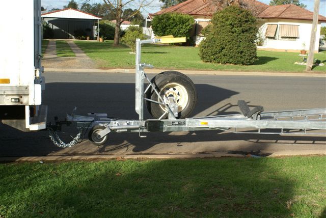

Taken a while with lots of interuptions and changes but almost there and hopefully ready to head north in less than a week but it's a pretty strong trailer which should handle anything we can throw at it and easy to fix on the road with all aussie components.
Also at 2800 kg rating won't have to worry so much about weight still don't like duals though.

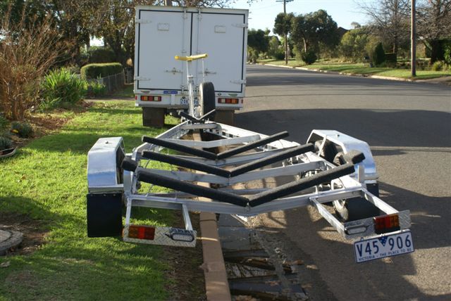

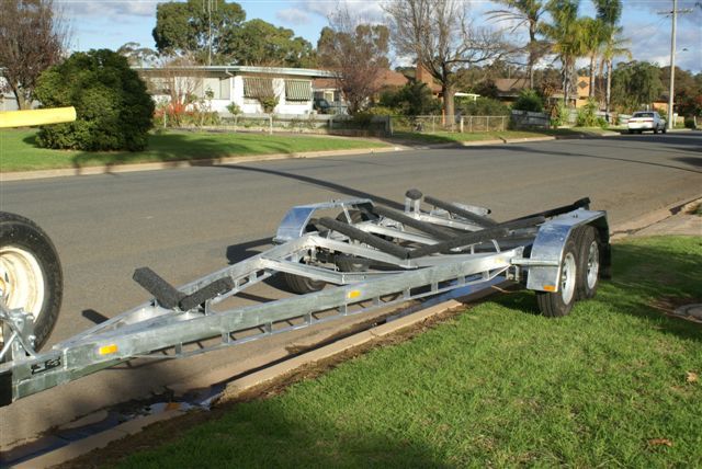

Yeah did it myself and it cost a bit over $4,500 after I got carried away with going for disc brakes and then having to use an actuator from the electrics, could have done it real cheap by just using electric drums but they really aren't suitable IMHO for boat trailers and have always had trouble with them in the past.
The galvanising blew out because they had to sandblast the original paint off instead of just pickling it and even then they had to do the front section twice which resulted in a heap of gal stuck in the drawbar :x .
Must have been good paint originally and very little rust under it after 7 years in fact the only small rust spots were under the rear berth supports.
It's a pretty strong trailer now, wanted 6 stud cruiser rims but too many complications so just went for the 14" 5 stud ford rims and easier to source when remote anyway and plenty of rating, bought most of the gear from huntsman trailers on ebay, very efficient.

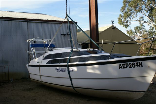

Luckily our son in laws father had a hoist so lifted the boat off and on again with that but blocked his shed up a bit due to extra time dipping etc.
Made the cross member under the dagger board heavier as the old one had broken away twice and all up it's a tare of 700kg now, the original was only 330 kg very basic but got plenty of extra rating now and the truck towbar is only rated at 2800 anyway.
Just about got trust me together but now got to load the dinghy in the truck etc, should have been gone a month ago.

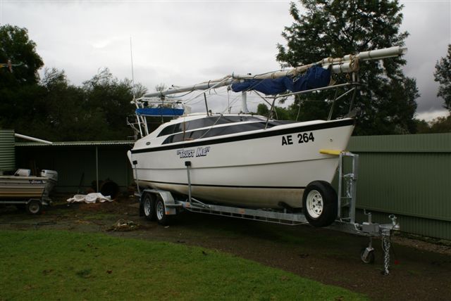

The surfaces of the disc's etc are all gal and the pistons are stainless but of course the rubbing surfaces are machined, other than a few bolts around the trailer everything is gal and whats isn't is cold gal, the old disc's were perfect after 7 years despite not being gal, any water can get away fairly quickly and if possible wash everything down asap.
My problems with the elec drums were that they fell to bits but did get some heavier duty ones that seemed to hang in eventually, was told they only last max 2 years in salt so not worth the effort except as a short term option.
Good not having to worry about a light board anymore especially as I had it mounted too high, to give easy access to the transom and technically it was illegal.
The actuator was half price what the trailer mob tried to sell me in the kit but still $750 with breakaway and aussie made.
The rims and tyres were only $110, cant believe they can do them that cheap esp gal, the tyre place here wants more than that for similar tyres only, they apparently supply a lot of trailer manufacturers.
