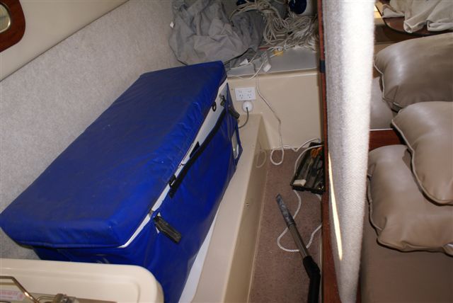

Reckon we need a bigger one than the 70l, have an evercool which is fairly long and low so the lid can lift up on the bench opposite the head might even put another compressor (the third) in it but will use the bigger one as it drops it down quicker, we take the basket out and put a polystyrene divider in (brocolli box) which forms the freezer and then put a piece of polystyrene across the top but allows enough leakage to suck down the bit of the cabinet left for drinks etc.
If I do repair it will move the compressor out of the box which will allow more airflow and fill in the walls which should give us about 90l.
Most days in the dry (winter) are 32c or above and the interior of the boat is a fair bit hotter even on the water we bring the freezer home as full of fish as we can at -18c.
We only have the original starting battery and two 70ah batteries but can use a bigger one under the front berth easy but it works as is because we have so many options for charging and like to keep batteries topped up as high as possible at least once a day.
Sits right next to inverter and dc plug which taps into heavy cables linking batteries to cut down voltage drop.
