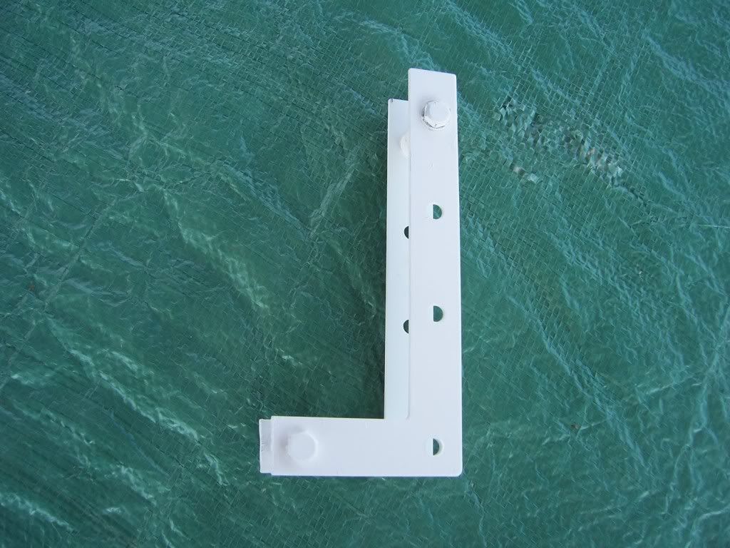

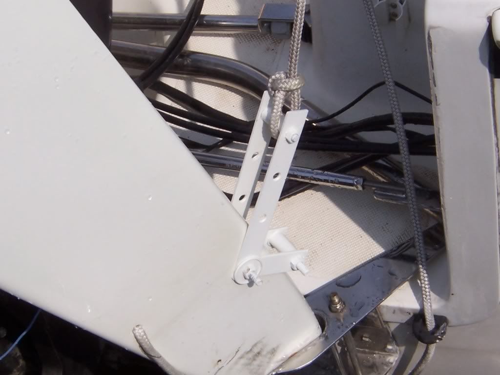

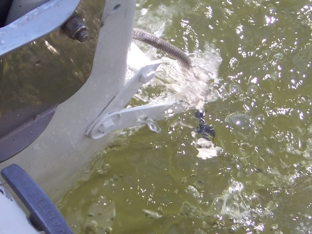

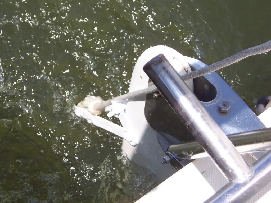

The attached pic's show what I came up with and they work like charm. I can now one arm them up with no problem.

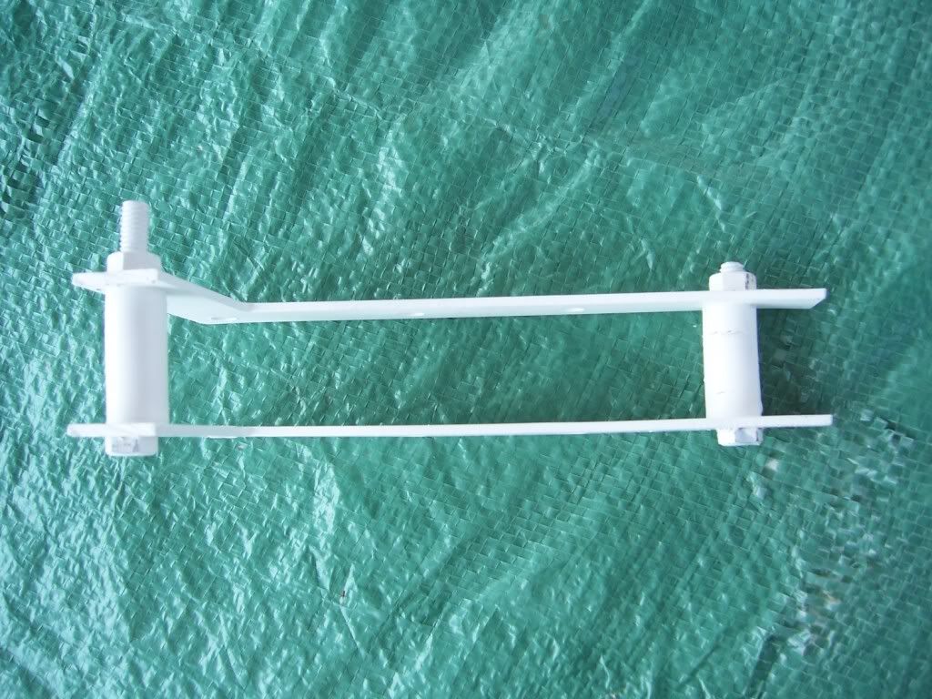

I simply used 4 fairly solid L brackets, cut off some of one side and drilled a hole in the elbow of each of them to pass a bolt through and attach to the rudder as the fulcrum point. I did not want the bolts rubbing on the rudder's surface so I used some pex pipe as a buffer and spacers. Painted the whole thing with white rust paint and attached the lines.
