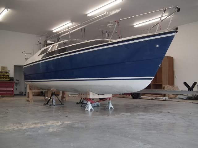

Here is a link to my post on removing the boat from the trailer and placing it on blocks.
http://www.macgregorsailors.com/modt/in ... ?view=1468
