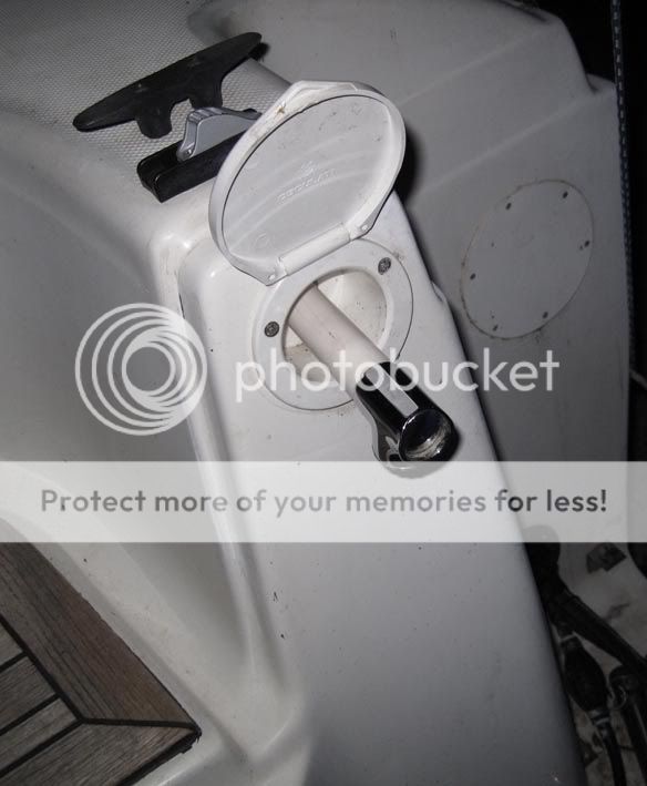

Hi, in the following some information about my pressure water installation.
It is based on a 100 l - Plastimo flexible tank, a Shurflow Marine Fresh water pump and a small accumulator located under the front bunk.
Only the upper left corner of the blue Plastimotank is shown of this picture.
As I was affraid of cutting a hole into the outer surface of my
so the water inlet was placed on top of the galley.
If You do this don´t place the inlet as close to the wall as I did. I have some problems when filling from a water jerrycan instead via a waterhose.
Also the pump is activated automatically by the pressure I integrtated an on/off toggleswitch placed at the side of the galley.
The fresh water supply hoses are leading to the replaced faucets (fro a Campersupply shop) and to the shower.
It was a little bit tricky to get the showerhose initially through the foam to the right place. But now it can easyly be pulled out and stored back again.
I don´t have a filter integrated, the fresh water is exchanged regularely and the tank is emtied completely for the wintertime. This way it´s working for five years now without any problem. Hope this will help You find Your solution.
Rainer
