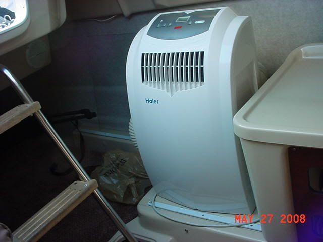

Installed one of these room air conditioners. They are self-contained and can be wheeled around from room to room. The exhaust duct tubing was run under the rear berth locker area and exits through a dryer type duct flapper above where the steering shaft exits.
9K BTU
A drip tube was tee-ed into the sink drain and the units castors removed and replaced with 3/8ths bolts (4) to mount the entire unit over the left part of the sink locker area.
The unit will blast good air circulation, however since the entire unit is inside the area to be cooled, heat from the machinery and condenser are cooled within the unit with split duct designwork and that heat is carried off in the duct tubing which gets quite warm, so it is important to stow the ductwork under the bunk boards with insulation blanketing. (I use supermarket heat bags I cut and wrapped the pipe with) works real good. I think the trade-off in heat transfer reduces the actual 9K advertised BTU to somewhere around 5-6K BTU's The picture below shows the unit in the process of being installed with the ductwork rolled and stashed behind the unit. The init power cord can be seen however not seen is a built-in GFI that comes already installed on the power cord which I mounted on the sink cabinet side closest to the unit. I ran the rest of the cord to my shorepower outlet connectors.
In the Florida summer heat (97 degrees by noon) the unit will pull the cabin temps down (usually around 110 degrees with cabin closed up) ... to approximately 78-81 degrees inside of an hours time. At night 72-74 degrees.
Runs on 117VAC 60HZ and requires 900Watts to operate. At the dock or tethered to a generator, she runs well. At anchor I use a Honda eu2000i generator. It handles 1600 watts with a 2000 surge rating. I also use 2 CO detectors inside the cabin. Will run the unit by itelf continuosly for about 4.5 hours.
Purchased this unit at Target for about 360 bucks. An identical model sells for over 400 bucks but is a reverse heat pump and will heat the cabin nicely I am told.

I put my exhaust port just aft of the spreaders in the window and placed my unit on the forward end of the sink and used fans to circulate:
