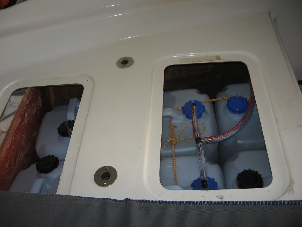

Re: Potable Water and Epoxy
I have 4x20 litre and 2x15 litre water cubes under the forward dinnette seat.Two of the 20's are plumbed together and connect to pressure pump for head sprayer and transom shower.When empty change spears to others and the emptys become extra flotation.The 15's are for the galley which is still manual and plumbed the same to use one at a time.
