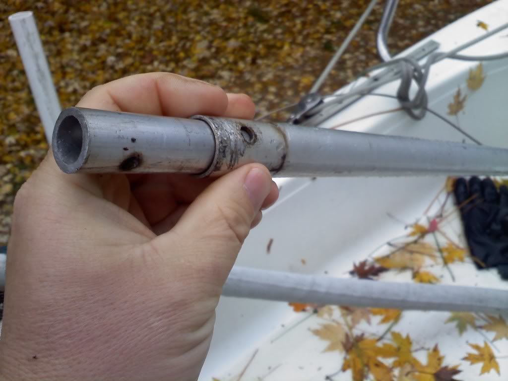

I bought aluminum tubing from Ace Hardware (other places had slightly the wrong size) and then put a piece of pvc tubing in each. That was several years ago and I haven't bent one since. Wood might be too unforgiving and you could break the fitting before the spreader gave.

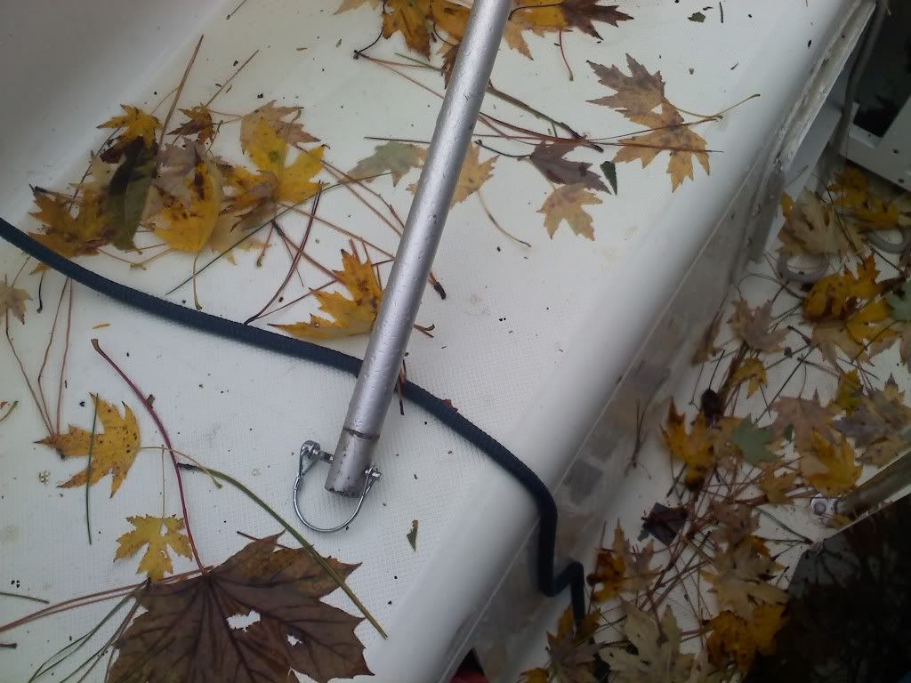

The are many ways to do this. The most common is to install a pelican hook where the life line attaches to the bow pulpit. I went the oppisite route and installed keypin shackles in place of the standard shackle at the aft end of the forward lifelines. I simply slack them both then lay the mast right on top. This removes all the stress on the spreaders and makes raising and lowering the mast even easier as you never have to do the side to side spreader dance.

I used these Keypin Shackles, two for $28 is pretty cheap for a mod that takes all the strain off the spreaders and makes raising and lowering the mast quicker.
