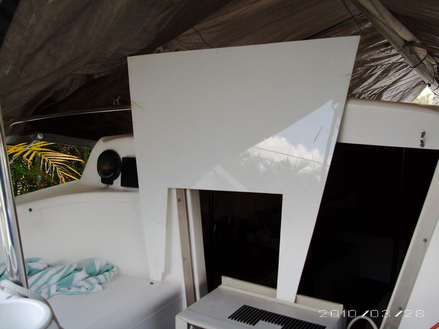

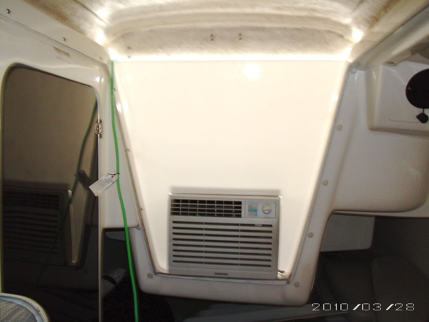

how do you mount it??
pokerrick1
Posts: 2269
Sailboat: Venture 23
Re: Very Nice Little A/C
Post by pokerrick1 »
What dvideohd asked :?:
Rick :( :macm: Less
Rick Westlake
Posts: 778
Post by Rick Westlake »
dvideohd wrote:how do you mount it??
In the companionway ... of a 26X. Sorry 'bout that.
vkmaynard
Posts: 1011
Post by vkmaynard »
Like this on a 26X..
DaveB
Posts: 2543
Post by DaveB »

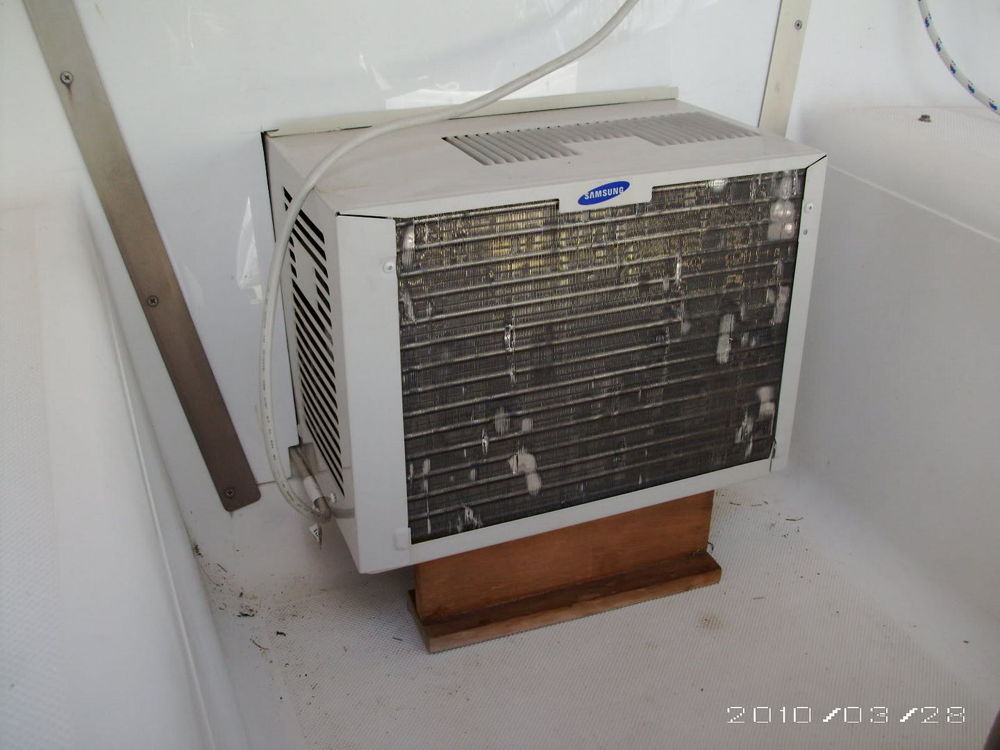

I bought that Figidare a Mo. ago because I thought mine was laeaking freon as the cabin burt eyes and a slight smell. Come to find out it wasn't the AC it was the carpet I installed 4 mo. ago with rubber backing.
My original was a 5050 btu Samsung that is much more efficiant than the Frigidare.
The frigidare is same height but 1 inch less in width.
Here is pictures of the Samsung installation, don't have pictures of the frigidare but I have to put foam on one side to fill the gap, going to put my Samsung back in and keep the Frigidare as spare.
