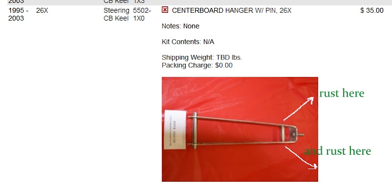

After 5 years trailering in and out of salt water, my centerboard SS hanger rusted out in two places and the upper SS pin that is welded in place was hanging on by only a small piece of weld. So I ordered a new hanger from BWY (thanks for being there Blue Water, great service).
Before I install it, is there any recommendation to protect it with paint or grease or anything else? Thanks,,,

Since Kmc laid out what to do, I thought I would elaborate on the part picture.
Here it is from BWYachts (Note- this website's parts list does not work with Google Chrome on my computer. I had to use Firefox or IE.)

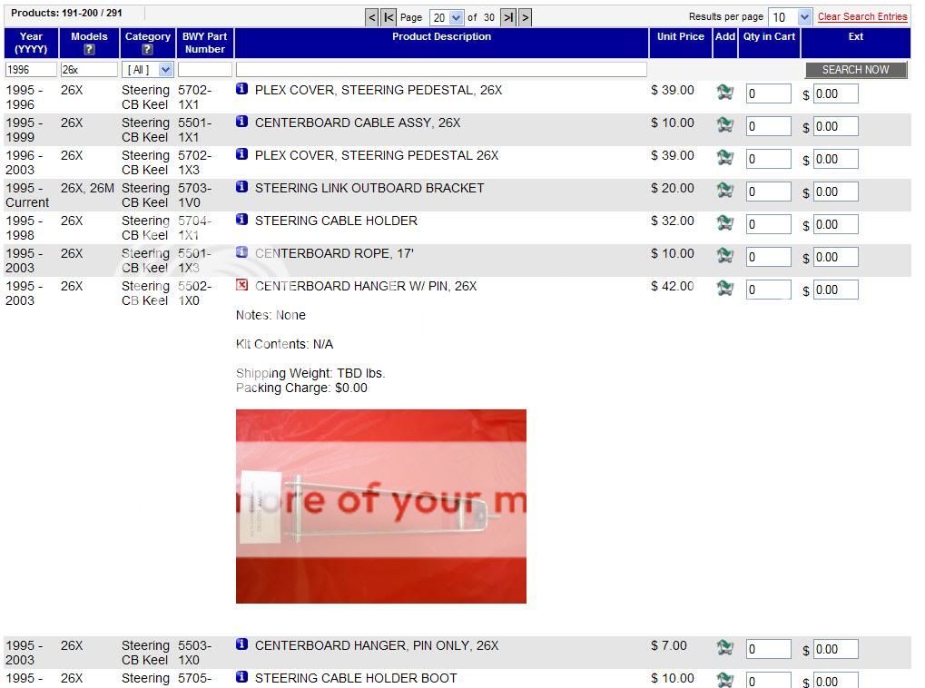

I´ve been searching on the forum for mods related with the centerboard system. Also I googled in themes and pictures but couldn´t find any help to find correct measurements.
OK..: I plan to order a hull clean and paint at shore installations in a few weeks. In order to replace the "HANGER BRACKET"+"PIVOT PIN" as well as the "VALVE SHAFT" on the ballast system, I need to find (or order to a local welder)those pieces prior to any painting.
¿Do you know where I can find measuring data or supplies for those items?.

The centerboard hanger is still in the Blue Water Yachts online catalog.Their URL is http://www.bwyachts.com and you will need to use Microsoft Internet Explorer, Firefox or Opera as your web browser.
Here is what I found in the Blue Water Yachts online catalog:
You can find the valve shaft from the same source. No need to call a welder, just order the parts from BWYachts....
