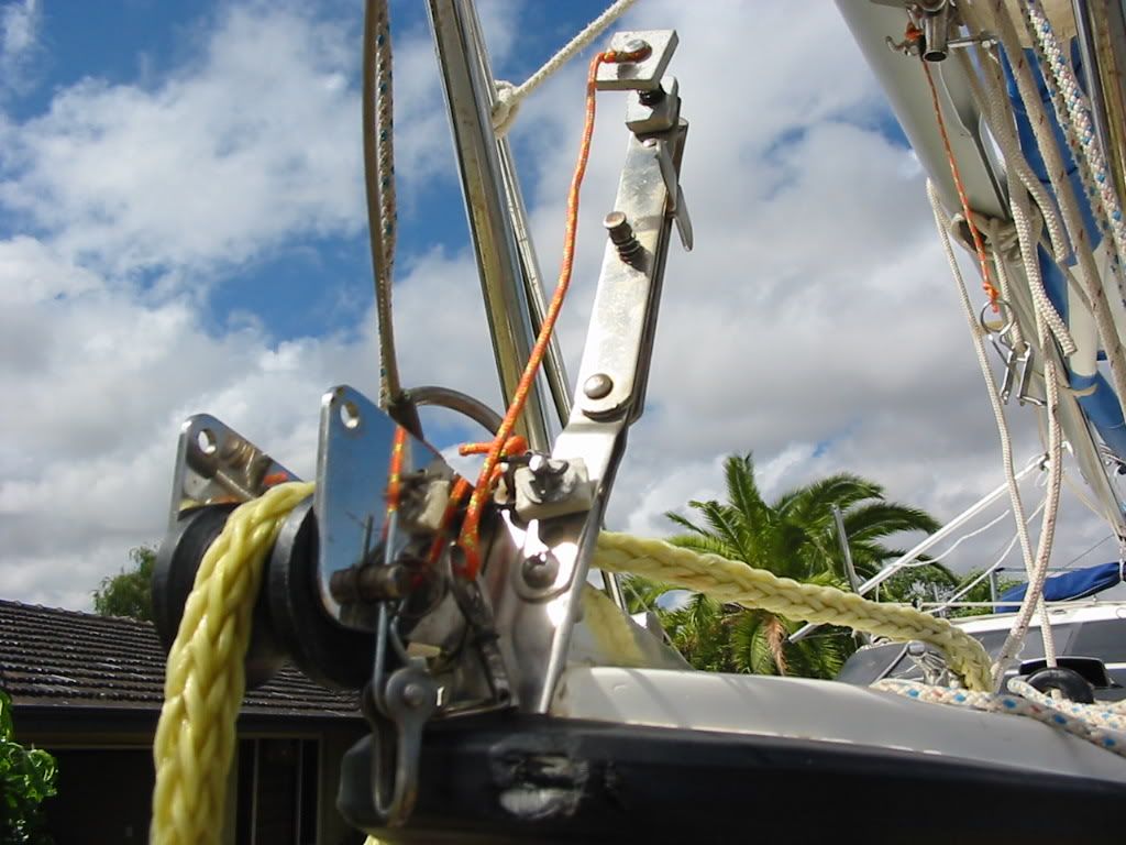

I think this picture may help.You can see it loose.When I put the sail on it's worse.

anyhow,here in this picture the boat is rigged & very visible

The MAC furler has two nuts on the bottom one is the adjustment nut the other the lock nut, there is a third one but it is pinned as a terminator. to shorten the forestay just wind up the adjustment nut then lock off with the lock nut. Pretty simple but you only have about 1 inch of adjustment before the threaded swage end blocks off the chain-plate clevis pin hole, unlike a turnbuckle with 2+ inches of adjustment. I think my next mod will be a proper forestay and turnbuckle

Looks to me that the furler was furled with slack in the line , both sheet line and furler line has to have equal tension when furled other wise the furler line will wrap around drum any way it wants to.
On my Mac.X I have the CDI 2 furler and if furled other than fully open the line would shafe on the stainless caseing that had sharp edges. I rounded out those edges with a dremel tool stone bit.
Also very important to have the furlers lead line 90 degrees to headstay.

I just have the line wrapped around so it won't drag the ground in this picture.
That was before Mark helped me put the sail on.I didn't realize both lines
had to have an even ammount of tension,thanks

Looking at that picture I have to ask how much tension is on the foresail sheets? The forestay looks loose, but if the sheets are cleated off they will pull the forestay into that curve of course
