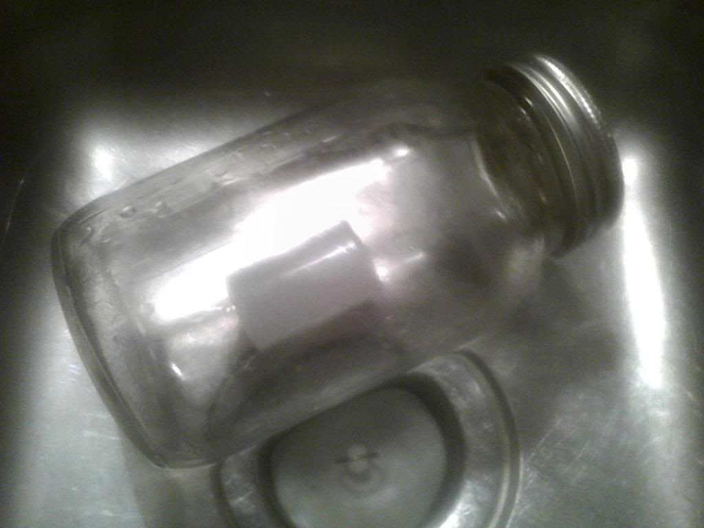

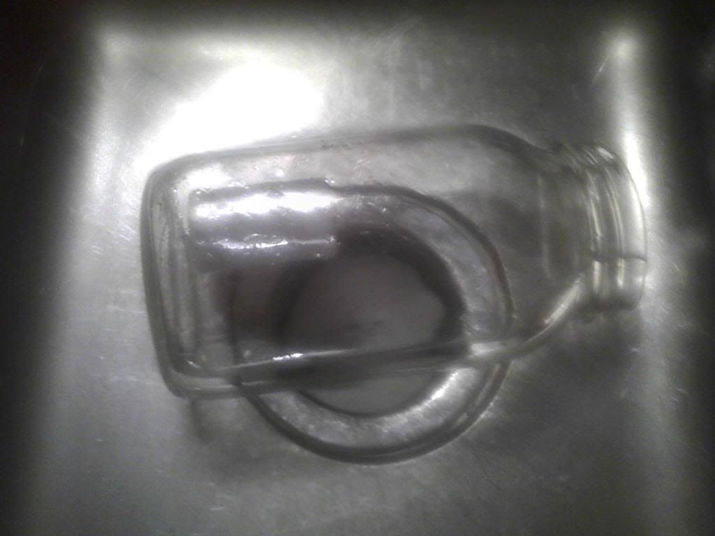

A simple experiment with the only things I could find in the kitchen that would work.
In the bottom image the film container is full of water. It acts as ballast and keeps the jar from rotating (unless I rotate it enough to make the film container roll).
In the top picture the lid was removed and the jar flooded. The film container is still full of water. The film container now floats with just the minimal amount of buoyancy that the plastic in the container itself provides.
The water is neutral but the plastic floats. What if it were even an eighth full of air? Is there any chance that something that floats will provide any ballast?
If the water were in a container that was more dense than water it would sink and provide just as much ballast as the weight of the container itself would provide and the water would contribute nothing.
