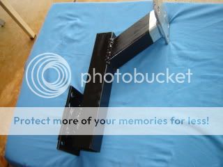

On my 2002 trailer it mounts on the tongue rail, right behind the ladder. I think the M is the same for the 2004-5 years.
Ive bent the bracket a couple of times - they cost about 20 USD to replace....

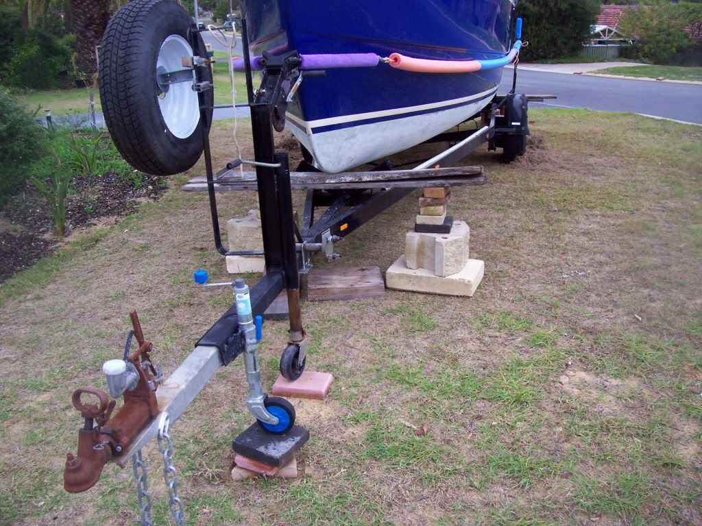

I took a piece of 1/2" all-thread and bent it into a "U" shape. I used it to hang our spare tire on the ladder. The top of the tire is at the top of the ladder and makes an excellent step when working around the front of the boat on the trailer. 1/2" is the thread of the lug nuts so it carries a couple extras, just in case.

btw, i put mine sideways on the ladder - in this position it will hit my van when I back up ) if I cut it sharply.....(I put a big dent in it, which luckily pulled out with a plunger)

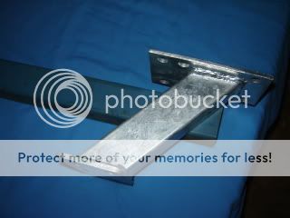

Just finished my spare tire holder. Bought a gal version - Probar $35au. Had to cut it and weld a piece in so the spare was raised for ground clearance and set further out away from the hull.
Just need to keep the paint up to it re rust factor.

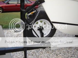

High up, like this...so it doesn't get wet when launching...
