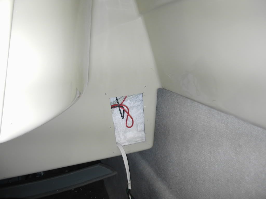

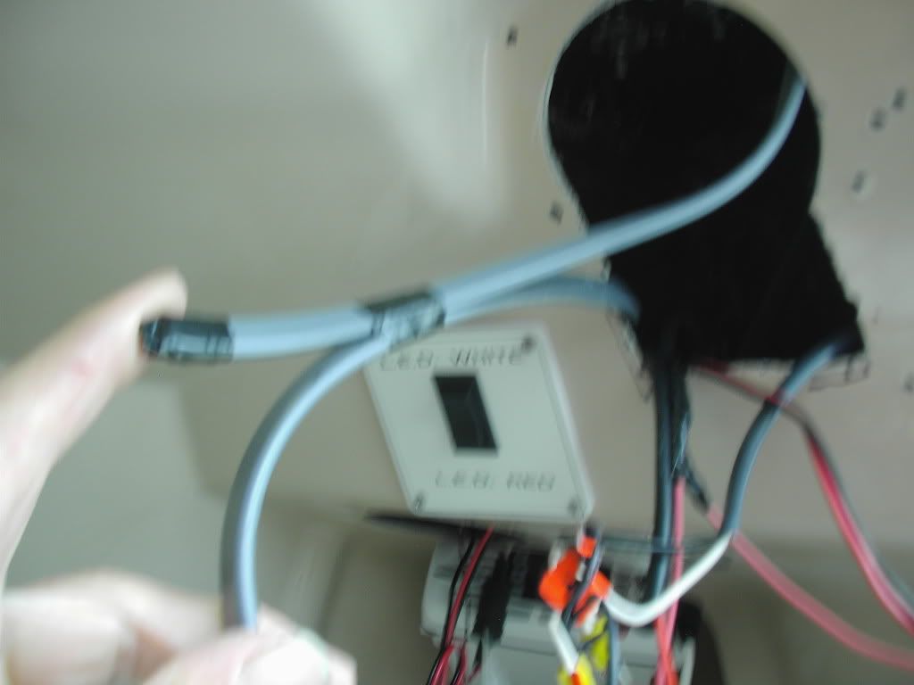

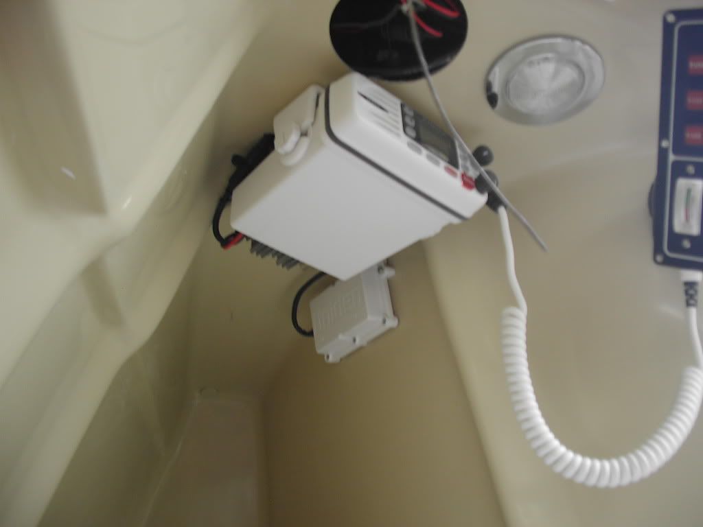

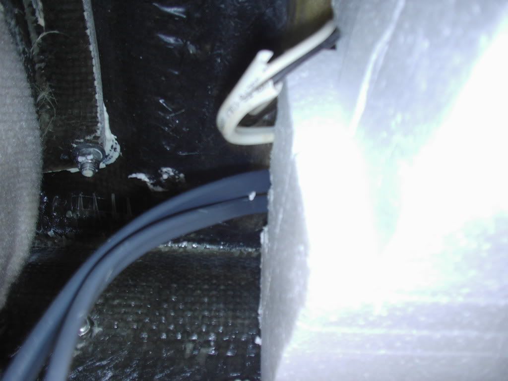

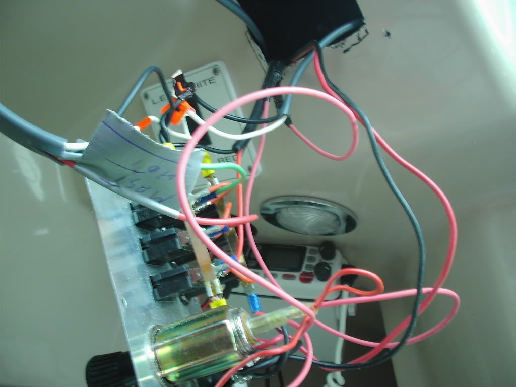

Mechanics wire get the thicker heavier stuff not the light stuff you can bend it , shape it , twist it , turn it as you feed it into where ever you are trying to reach ! when running wires up to the area above the mirror on the S/B side of the D/B trunk I ran extra wires while I was there
http://i235.photobucket.com/albums/ee20 ... 0002-3.jpg
same again above the S/B side aft berth entrance where the little round mirror was for access to the winch mount bolts I installed a another switch panel there also
http://i235.photobucket.com/albums/ee20 ... 0009-1.jpg
http://i235.photobucket.com/albums/ee20 ... 0008-3.jpg
http://i235.photobucket.com/albums/ee20 ... 010010.jpg
http://i235.photobucket.com/albums/ee20 ... 010027.jpg
on the P/S aft berth area where my 110v, main hydro panel is you can also see were I ran two extra 10g red/black wires up to the main 12v panel above for future use
http://i235.photobucket.com/albums/ee20 ... 010072.jpg
http://i235.photobucket.com/albums/ee20 ... 010073.jpg
Now the Pedestal have fun
http://i235.photobucket.com/albums/ee20 ... 010003.jpg
http://i235.photobucket.com/albums/ee20 ... 0013-1.jpg
http://i235.photobucket.com/albums/ee20 ... 010016.jpg
Hope this gives you some Idea's
