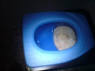

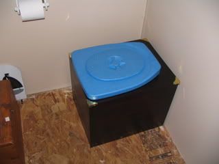

These pics are of a waterless toilet I built for use at my little wilderness cabin up north.
I has preformed well for us and I will now be designing one for use in our Mac.

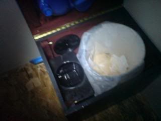

Urine us diverted to a hose that can lead to a container or diverted to the heads thru-hull fitting.
# 2 is collected in a 4 gallon pail lined with compostable plastic bag, and covered with a scoop of sawdust after each deposit.
As needed the bag is tied and at the cabin placed in a backyard composter, at the marina will be deposited in the DUMPSTER.
This system is near odourless due to the sealed lid, had been much less offensive than the marine porta potty and pump out system we have had the last 5 years on the mac.
