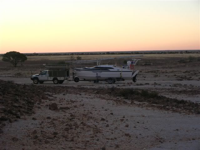

We are well overloaded and the trailer tows like a dream the springs are heavy duty and have coil assist ($35 at the wreckers) with Rancho adjustable shockers the vehicle sits dead level.
Haven't weighed the rig but the boat would be easily 5000lbs and the vehicle would have min 3500lbs load above base empty weight.
We only pull at 50mph most of the time mainly due to poor roads and for maximum fuel economy but did 7000 k's (4300m) this year.
Many larger vehicles had load leveling devices on much smaller loads and wouldn't tow without them but we had no problems even at higher speeds occasionally, with an empty vehicle and little load in the boat you don't even know it's there.
