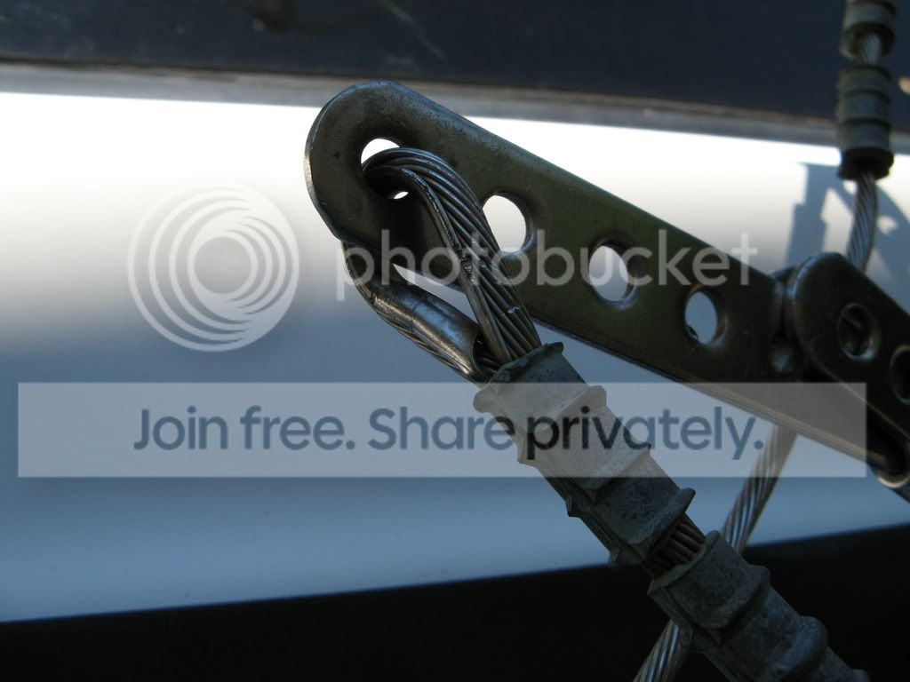

Is this OK? While raising the mast in the driveway and found the Nicopress Eye a little bent and worn.
I know this is a loaded question, but is that OK for now?

I don't see any problem with it. How old is the boat? Did you do some trailering recently? How tight are your stays?

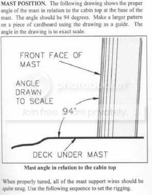

It's an '01. We picked it up and Maine and trailered to NH on Tuesday. We went to figure out how to step the mast in the driveway today. Shrouds are taunt. Mast has about a 3" bend judging from the Main Halyard, and the rake although hard to judge on the trailer looks close to 94deg.
The cable is just a little bent at the thimble and I thought it would be a good idea to get a more seasoned eye on it. Thanks for lookin'.

A little bending is ok. You want to look as well as you can into the swages for signs of separation of the shroud strands - if I even see one on a piece of standing rigging, I replace it. Havent see one yet on my 2002 :macx:

SailDog wrote: . . . Mast has about a 3" bend judging from the Main Halyard, and the rake although hard to judge on the trailer looks close to 94deg.
I'm not sure about the "greater sailing world" but here in Macville we'd usually describe that differently. Roger's standard mast rake with factory rigging is 4 degrees aft, or 86 degrees off the aft deck (granting the corollary, that's 94 degrees off the foredeck ;) ). I replaced my forestay, having it shortened by exactly 4 inches, yielding a 2-degree aft rake.

As for the rake angle, I was just parroting what I saw in the manual... :wink:
