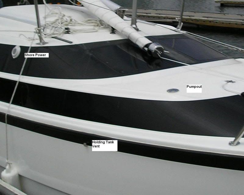

This season we are adding a porta potty to our boat which can be pumped out. I have a question about the install though. There is a 5/8 vent line which I am unsure where I should drill through the boat. The west marine salesman says out the side above the waterline. Do I need a vented loop on this hose?

Hi Kevin,
It sounds like your vent line simply vents the tank directly, right? If so, no need for a vented loop. Vented loops are run where water or waste-water flow from one place to another - like from the head to a holding tank, or from the head directly to the sea. The vent in the loop acts to break any suction and siphon action, keeping everything where it's meant to be. Without it, it's possible to backflow waste-water, empty a water-supply tank, or even sink some boats with an open seacock.
It sounds like in your case, you're just venting an all-in-one porta-pottie-type tank - so no vented loop necessary - if the vent outlet is kept higher than any-and-all water levels (uncluding seawater at all angles of heel). You will have an odor filter on this line, yes?
On Edit: BTW - Installing the vent line fitting either in the hull, well above the water line, or on the deck is fine. For the latter make sure the fitting doesn't allow water or debris to fall down into the vent line.
