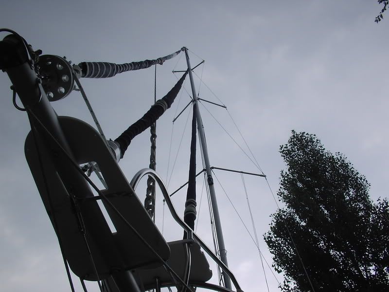

Try this ! :D :P :wink:
in this pics you can see that the storm jib & the two furlers all have quick release levers Terry their about $80. but theirs a place in Sidney you can pick them up used for around $20-$25. Terry you can see my lazy jacks also in this pic
in this bowsprit pic you can see alittle more detail
Their a nice feature when pining the forestays

All the statements I made about the rigging up grade http://macgregorsailors.com/cgi-bin/mod ... record=892 I failed to say another benefit to me was placing an extra hound on the original forestay attachment on the mast allowed me to fit the spinaker halyard there. The benefit to me is that I can gybe the spinaker inside the forestay
