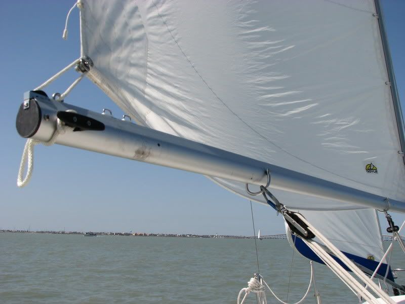

Securing the single pulley took some thought, but here's what I did.
I decided didn't want to drill anymore holes in the boom than neccesary, and figured out a way to use the 1/4" bolt that secures the alum. end cap to the front of the boom. A tricky move here meant drilling two small .075" holes close together in the end cap, such that a simple plastic twisty could pass through to pull the eye end of the pulley hard against the inside of the cap. That done, and end cap back in place, the bolt pushed home nicely capturing the pulley to boot.
I also drilled a 3/8" hole in the same end cap that the knotted fixed end of the line ( that runs back to the cockpit) pops out of.

Delevi, nice job on the adjustable outhaul and thanks for posting the pictures.
Im going to a loose footed sail this year and have been working on a 4:1 outhaul (similar to what you have) with the control on the boom end but I like your idea of having the outhaul control available from the cockpit. Might even be dangerous trying to adjust it from the boom end?
Im curious what you think about 8:1 vs 4:1? Is the 4:1 going to be too difficult to adjust under load?
Ive used adjustable outhauls on windsurfing sails for many years and really like them. I ended up with an 8:1 on the windsurfing sail because sometimes it was nice to be able to tighten the sail under a full load.

Walt,
4:1 may suffice just fine, but if you're already going through the trouble, why not go with 8:1? I found that you really need extra power for the loose-footed sail. Also, adjusting under load in say 15 kts. wind to really flatten the sail, you'll want the 8:1. Yes, having access to the outhaul in the cockpit is awesome and it can be very inconvenient if not outright dangerous to reach for the boom to make adjustments. One can make the same case for reefing.

It was fairly simple to go to 8:1 (2:1 at the sail clew and 4:1 under the boom) so I did. Im going to put the outhall control accessable from the cockpit while sailing - very simiar to what Delevi did.
I ended up with about 6 inches of travel of the sail clew total. Hope this is adequate.

Still tweaking the system.
I still have the bolt rope attached along the foot of the sail. It appears to be sown in place. Any advice out there on whether I should remove it, and how.
Since my original posting I have now removed the 2-shackles in the boom track as they appeared to bind with the side forces under sail, slowing down the action.
Cheers.........R
Cheers.........R
