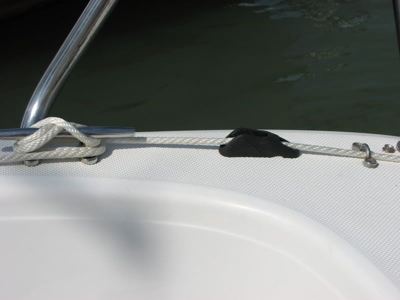

2001-26X with attached 9'-6" dinghy using 2 alum. struts plus 1-anti-sway bar. Rubber strip on the struts gives a firm footing going aft. The chain sway link in 4 places is restrained by a 3/8 x 4" pin dropped in between a pair of 3/8 eyebolts on Mac transom, also the dinghy transom.
1/4' line both sides can easily be pulled up and initially secured on a Ronstan "V" cleat at the required height,and then more securely attached to the adjacent horn cleat. These lines can go back to the winches for more leverage, if req'd.
Dropping or lifting s'board rudder involves temporarily lifting the anti-sway bar to one side.
Releasing the dinghy from the Mac only requires pulling out 2 3/8 x 4" pins, and you're off.
Total cost for everything was about $110, and ran about 5-6 hours messing about, fine tuning,etc
Now down in South Texas for extended sea trials......... :D :D :D
Will report back in due course
Cheers.....R
Nicely done piece of work - elegant in simplicity.

I had once drawn up a similar system but in a mockup there was too much play and pressure on the dinghy skin for reliability.... because it didn't dawn on me to tow the dink backwards.... duh!

Nice Mod. Seems like most of the bareboat charters I've seen in the Med use an elevated tow backwards plan like this. I would think the other advantage here is that you could leave the outboard motor mounted on the dinghy pretty easily and that would certainly minimize the hassle factor. For my norm of 1-3 day type cruises, its usually too much hassle to rig up a dinghy too (plus the fact that you can always get pretty close to a Florida beach with the Mac), but this would certainly be a good way to tow on a longer cruise.

Thanks for the positive comments. Yesterday out in 20 mph winds the dinghy sat behind behaving beautifully. Very stable with no worries.

Nice work Ron I'll use your plans to make a proto type for my own smaller two man dinghy that does not have a hard transom
How long are your lifting poles !
john
R Rae
Posts: 259
Joined: Fri Apr 14, 2006 7:12 pm
Post by R Rae »
Thanks John,
Lifting poles are 1 3/8" ID X 54" long aluminum.
Anti-sway bar is 1/4" X 1" X 36" long stainless.
cheers.......Ron
