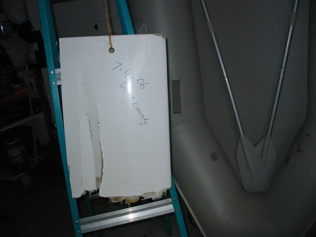

If you hit with a bolder with about 4 knots, you will come to an almost stop, gear will fall all over the place and screaming and shouting will take place.
After a split second your speed will accelerate to the previous 4 knots and the admiral eventually will stop screaming and jelling.
After a short evaluation of your boat you will continue with your journey just to find out that the boat is acting funny.
At your next anchoring spot you will get your scuba gear out just to make sure there is no damage to the bottom of the boat.
During your decent you remember that you left the dagger board down just as you see that there is no dagger board in the water.
With a closer evaluation of what was happened you find the remainders of your dagger board tangling from a rope.
Back on deck you pull your cell phone just to call Bill from Boats 4 Sail to tell him that you need to have a new board express mailed to you.
To my surprise there was no damage to the boat itself.
Once you get the new dagger board, the install takes about 5 min.
Your Admiral will fund some boat bucks for a second depth sounder what gets mounted on the bow of the boat and live will be good.

Unfortunately that had happened to me.
The reason was that the GPS with depth sounder was damaged due to static electricity during a thunder storm. However the original transducer is mounted in the battery compartment.
The additional transducer for the second depth sounder is now mounted underneath the head. I bought one original designed for a PWC for about $100.
